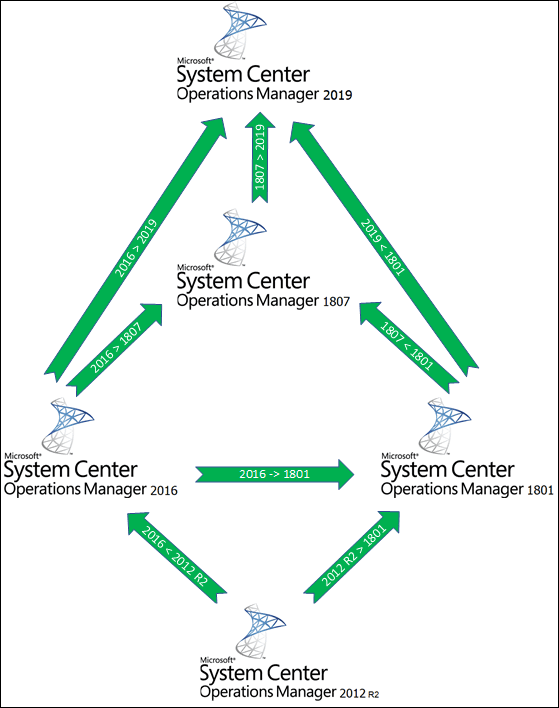

SCOM 2019 upgrade paths
The diagram below shows the currently supported upgrade paths for SCOM 2019.
Direct in-place upgrade to SCOM 2019
  • SCOM 2016 -> SCOM 2019
  • SCOM 1801 -> SCOM 2019
  • SCOM 1807 -> SCOM 2019
Indirect upgrade to SCOM 2019:
  • SCOM 2012 R2 -> SCOM 2016 -> SCOM 2019
  • SCOM 2012 R2 -> SCOM 1801 -> SCOM 2019

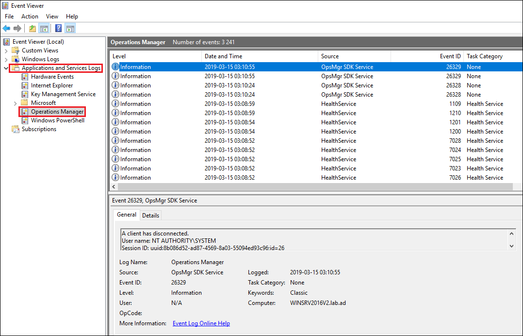

1. Go through the Operations Manager event log(s) on the SCOM management and gateway servers, this is mainly to check if there are any errors or warnings that might need fixing before upgrading.

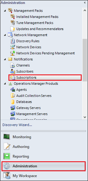

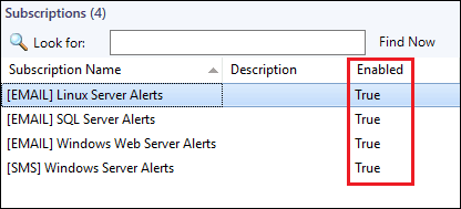

5. In the Operations Console, within the Administration pane, go to Subscriptions.
5.1. Make note of all the enabled and disabled subscriptions so that you remember which subscriptions were enabled/disabled.
5.2. Now disable all the subscriptions by right-clicking one subscription at the time and then choose Disable.
5.3. Once all subscriptions have been disabled, we can move on to the next task.

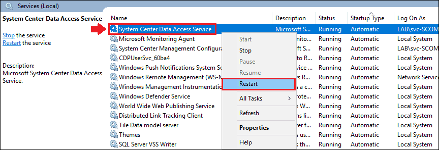

7. Now it’s time to stop the SCOM services below on all SCOM management servers except the one that is being upgraded.
  • Microsoft Monitoring Agent
  • System Center Data Access Service
  • System Center Configuration Management

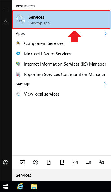

7.1. Go to Start and search for “Services” and then hit Enter to open it.
7.2. Find the SCOM services mentioned above, right-click on each service and choose Stop.
7.3. Once all the SCOM services have been stopped on all the SCOM management servers except the one that you are performing the upgrade on, we can continue to the next task.

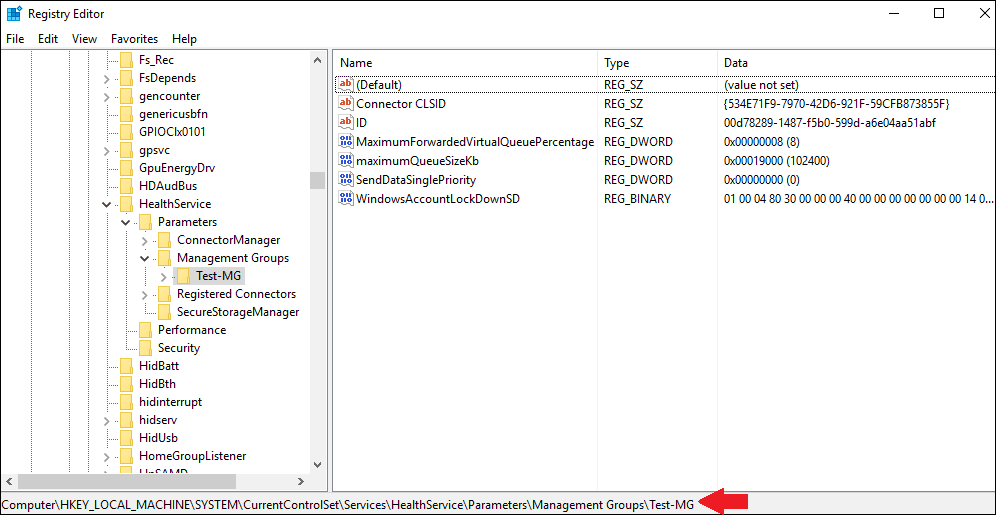

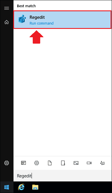

10. Next up we’ll increase the agent HealthService cache size temporarily for during the upgrade.
Go to Start and type Regedit and hit Enter to open the Registry Editor.
10.1. In the Registry Editor head to the following path:
HKEY_LOCAL_MACHINE\SYSTEM\CurrentControlsSet\Services\HealthService\Parameters\Management Groups<ManagementGroupName>
10.2. Modify the maximumQueueSizeKb registry key to the following value: 76800(75MB) or more, the default value should be 15360 (15MB).
Note: As you notice the value of maximumQueueSizeKb in the picture above is set to 102400, this has not been changed and it appears to be the default value in both SCOM 2016 and SCOM 1807, if this is the case, leave the maximumQueueSizeKb value unchanged.

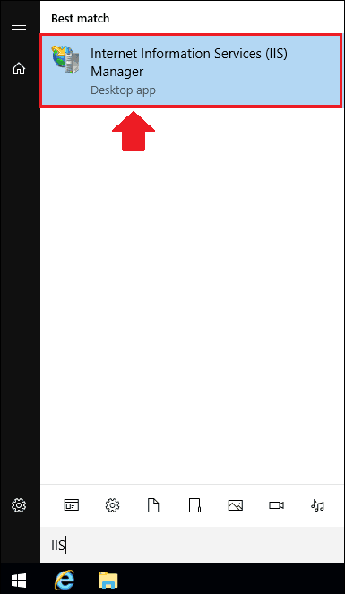

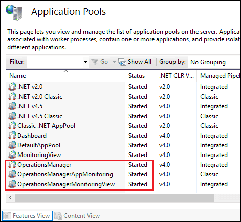

11. The final preparation task is to stop the OperationManager and OperationsManagerMonitoringViews application pools within the Internet Information Services (IIS) Manager.
On the SCOM management server, go to Start and search for “IIS” and hit Enter to open the Internet Information Services (IIS) Manager.
11.1. In the Internet Information Services (IIS) Manager expand the local serverand then expand the Application Pools.
11.2. Right-click the OperationsManager application pool and choose Stop, do the same for the OperationsManagerMonitoringView application pool.
11.3. Once both OperationsManager and OperationsManagerMonitoringViewapplication pools are stopped, we are finally ready with all the pre-upgrade tasks!

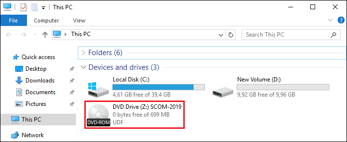

1. Mount the Operations Manager 2019 ISO image to the SCOM management server that we will perform the upgrade on.

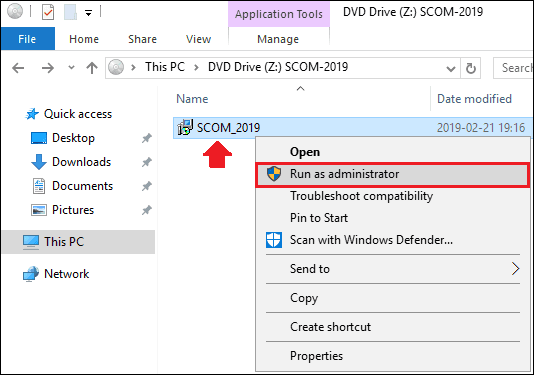

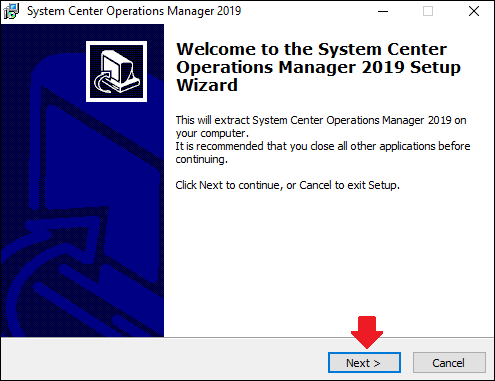

2. Run the SCOM_2019.exe (Run as administrator) to start the extraction wizard of the SCOM 2019 installation files.
3. Click Next to continue.

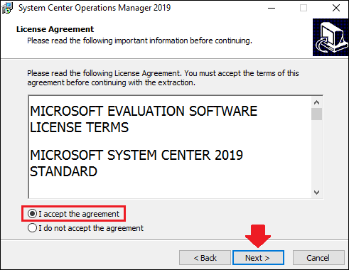

4. Check the I accept the agreement and then click Next.

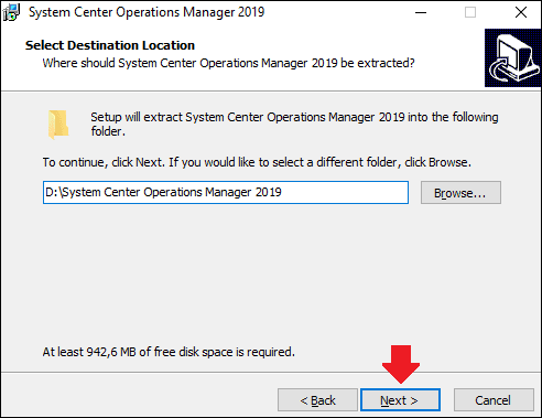

5. Specify a location where to extract the SCOM 2019 installation files.

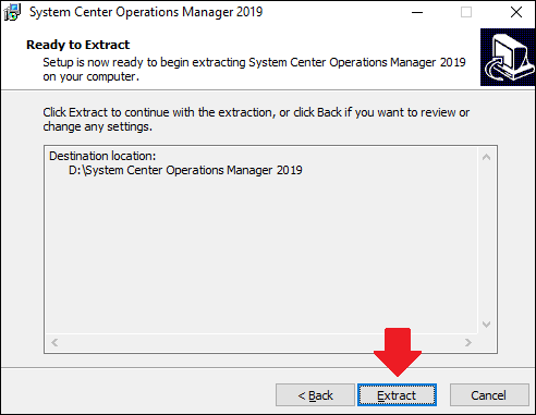

6. Click Extract to start extracting the SCOM 2019 installation files.

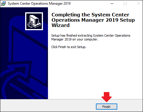

7. Once done click Finish to exit the extraction wizard.

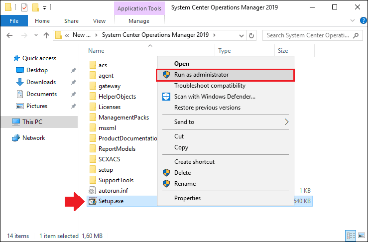

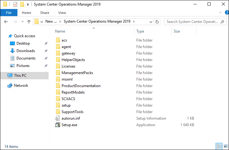

8. Next up, head to the location where the SCOM 2019 installation files were extracted to.
9. Now right-click the Setup.exe and choose Run as administrator..

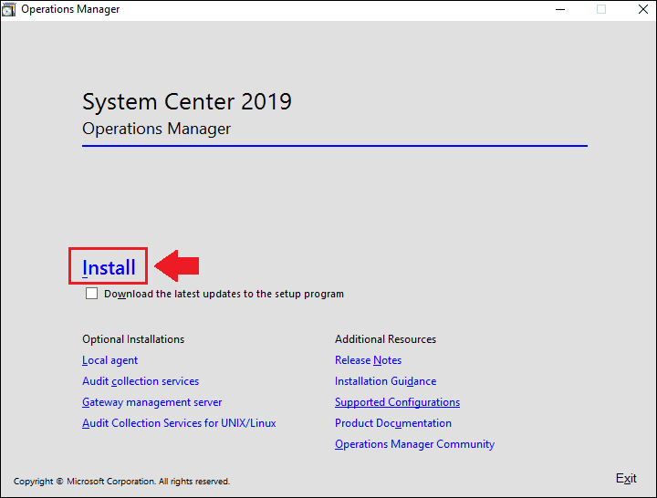

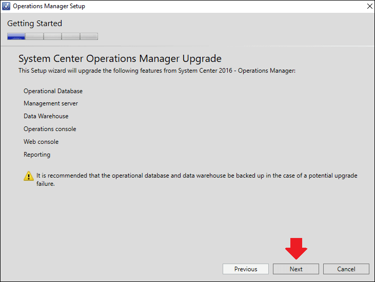

10. Select Install to start the installation wizard of SCOM 2019.
11. Click Next to continue.

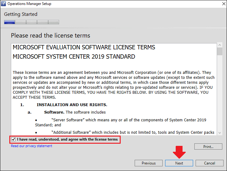

12. Check the I have read, understood, and agree with the license terms and then click Next.

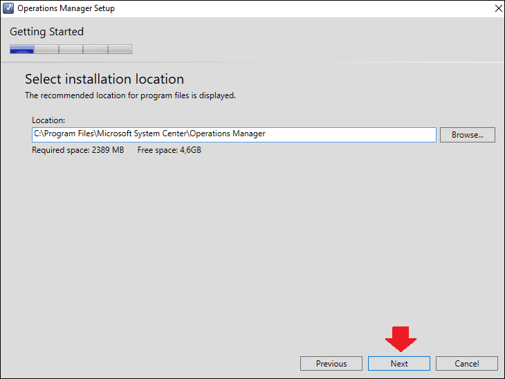

13. Specify an installation location or use the default installation location, then click Next.

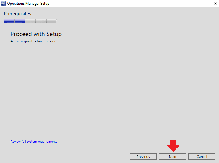

14. If all prerequisites have passed click Next.
Note: If you have a pending reboot it will be shown on here, it is recommended to perform the reboot before the installation.

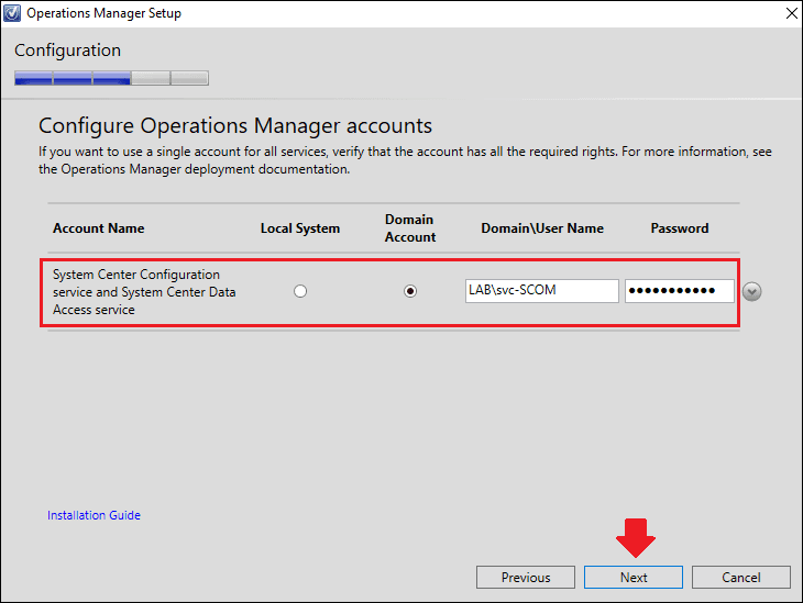

15. Configure the account for the System Center Configuration service and System Center Data Access service or use the builtin Local System.
Note: If the management server and the operational database are on different computers, the System Center Configuration service and System Center Data Access account have to be changed to a domain account.

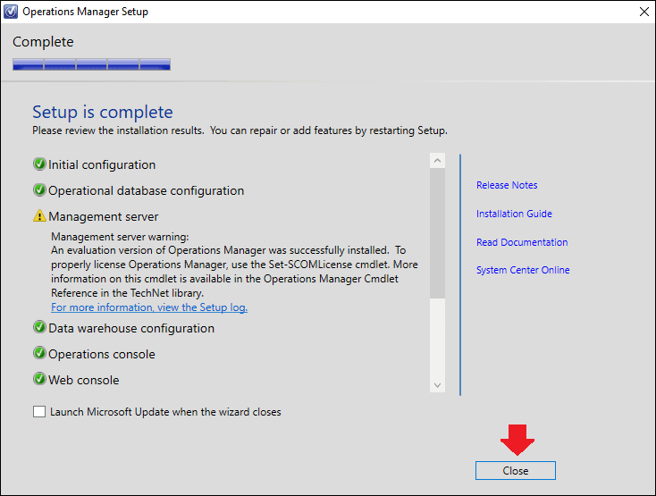

16. Click Upgrade to start the upgrade process.
17. Once the upgrade is complete, click Finish.

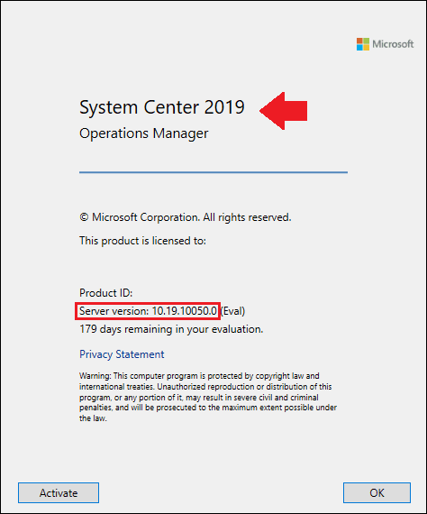

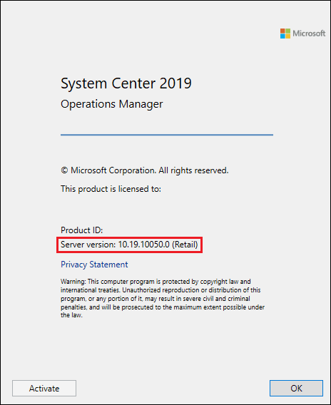

18. Let’s open up the Operations Console and check the version installed by going to Help > About.

1. Open the Operations Console and head to the Administration pane and select Subscriptions.
1.1. In the Subscriptions pane, right-click the subscriptions that should be enabled and select Enable to enable them.

4. If the agent HealthService cache size was modified in the registry we will have to change it back.
4.1. Go to Start and search for “Regedit” and hit Enter to open the Registry Editor.
4.2. Head to the following path:
4.3. Modify the value of the maximumQueueSizeKb to it’s default value: 15360(15MB).
Note: If the maximumQueueSizeKb registry key had another default value, change it to that value.

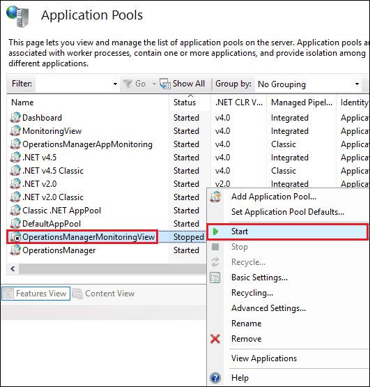

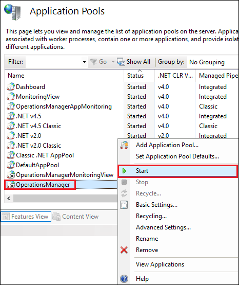

5. Now we will start the IIS application pools of the OperationsManager and OperationsManagerMonitoringViews within the Internet Information Services (IIS) Manager.
5.1. On the SCOM management server, go to Start and search for “IIS” and hit Enterto open the Internet Information Services (IIS) Manager.
5.2. In the Internet Information Services (IIS) Manager expand the local serverand then expand the Application Pools.
5.3. Right-click the OperationsManager application pool and choose Start, do the same with the OperationsManagerMonitoringView application pool.
5.4. Once both OperationsManager and OperationsManagerMonitoringViewapplication pools are started, we can continue to the last task to check the health of our new SCOM 2019 environment!

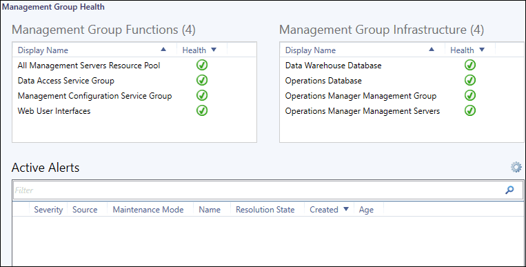

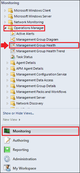

6. Verify that the upgrade was successful by checking the health of the SCOM environment and other monitors.
6.1. Open the Operations Console, and head to the Monitoring pane, then expand the Operations Manager folder, and select the Management Group Health dashboard view.
6.2. Now check the Management Group Health in the center of the screen.
6.3. If everything looks healthy, let’s have a final look at the Operations Managerevent log, if you do have errors, take action to see what the error is about.

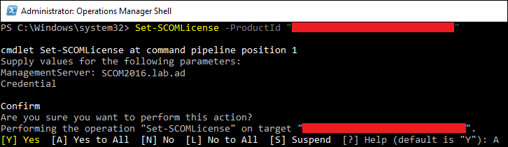

Configuring the license for SCOM 2019

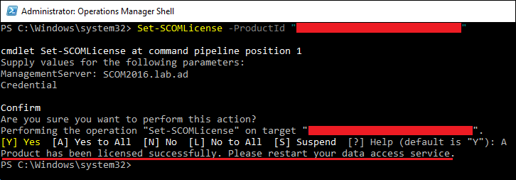

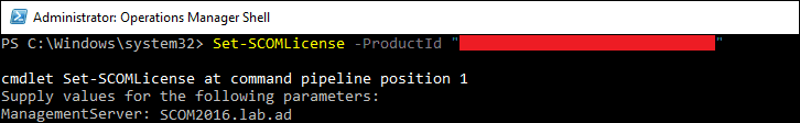

When we upgrade from an earlier version of SCOM, our newly upgraded SCOM will be an evaluation version, this means that we will need to set the license once again.
1. Open the Operations Manager Shell (Run as administrator) on the SCOM management server, and type in the SCOM PowerShell command below and then hit Enter to run the command.
Set-SCOMLicense -ProductId " XXXXX-XXXXX-XXXXX-XXXXX-XXXXX"
2. The command will ask for the SCOM management server, enter the the FQDN of the SCOM management server and then hit Enter.
3. We will now be asked for credentials, enter a username who has write access to the OperationsManagerdatabase, next we will be asked if we want to continue performing this operation, select A (Yes to All).
4. The command will run for a short while and once it’s completed we should receive the message below:
5. Now we will have to restart the System Center Data Access service on all the SCOM management servers for the license to take effect.
6. Go to Start and search for “Services” and then hit Enter to open it.
7. Look for the System Center Data Access service, select it and then right-click it and choose Restart.
8. Now open the Operations Console (close it if it was already open and re-open it), then go to Help > About, and we should now see that our SCOM 2019 is fully licensed!
We have now successfully upgraded from SCOM 2016 to SCOM 2019!
