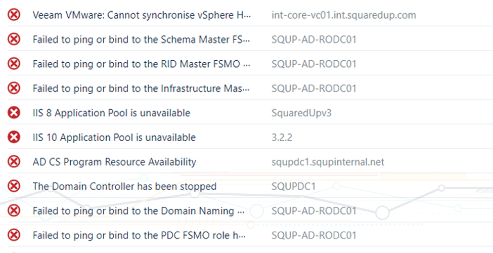

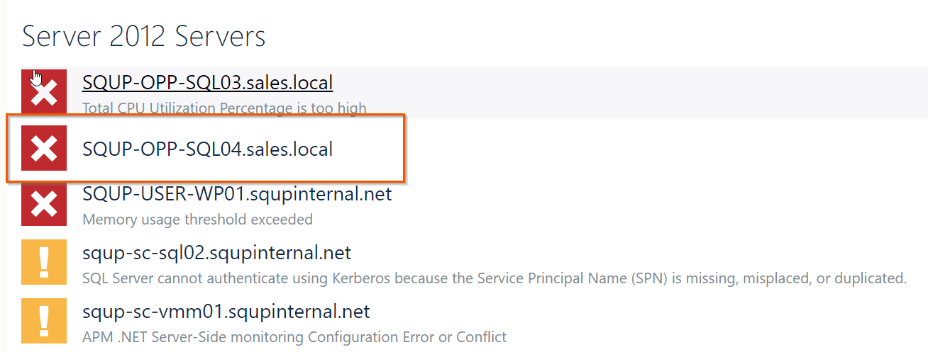

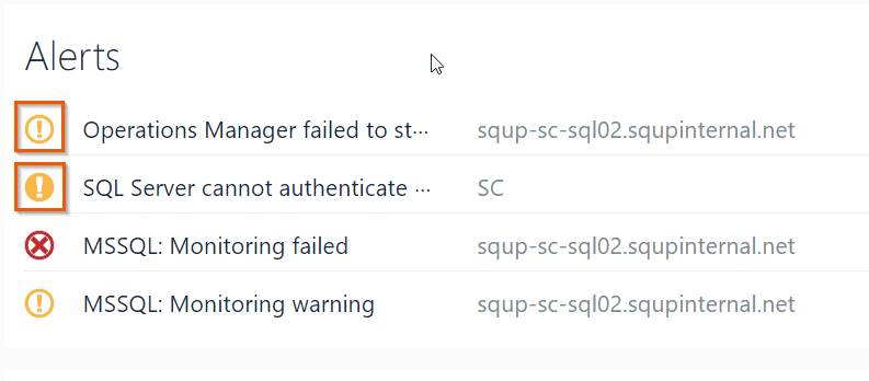

Firstly, we've taken the decision to use different icons to distinguish between monitor and rule alerts everywhere within SquaredUp. Now, when you see a solid-looking alert icon (one that's a bit like the health state icon, but circular) that’s telling you that the alert is affecting the health state of the object because it’s been raised by a monitor.
When you see a hollow-looking icon (one that's different from the health state icon) that’s telling you that the alert isn’t affecting the health state of the object because it’s been raised by a rule. Simple.

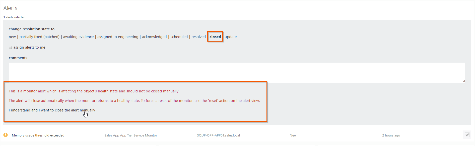

Now in v3.2, when a user tries to close a Monitor alert, they get a very clear warning;
This is a monitor alert which is affecting the object's health state and should not be closed manually.
The alert will close automatically when the monitor returns to a healthy state. To force a reset of the monitor, use the 'reset' action on the alert view.
After being presented with the warning, in order to actually close the alert, the user must go through a two-step process;
Not so easy to accidentally close them anymore!

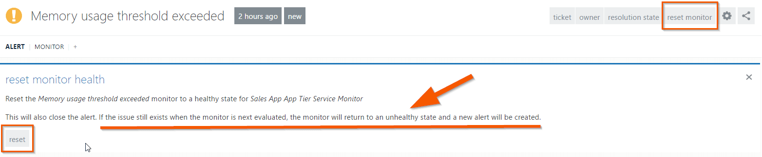

This has also been supplemented by giving the user the ability to reset the Monitor from the alert page, with a new 'reset monitor' button in the toolbar, together with a clear explanation of the effect of resetting the Monitor.
So, there you have it, no more excuses for your users, no more incorrectly closing Monitor alerts and clear visibility for everyone if a Monitor alert’s been closed without the underlying issue being addressed.
