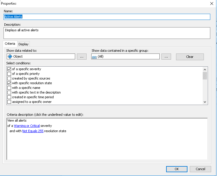

By setting these alerts as informational, you can then filter them from the Active Alerts view by only showing the Critical / Warning alerts.
If you still want to view these alerts, you can go to the Operations Manger folder. I would then focus on alerts that have a high repeat count, as this may indicate an issue with WMI or other resources.

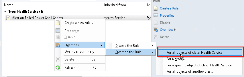

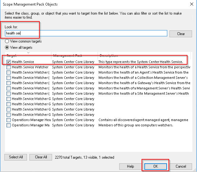

To create overrides for this, simply go to the authoring pane in the SCOM console, and scope to Health Service.
I would then recommend changing the severity of these alert rules:
Right click the rule you'd like to change the severity for:
Change the severity to 0 and store in your SCOM override management pack. ClickOK.
