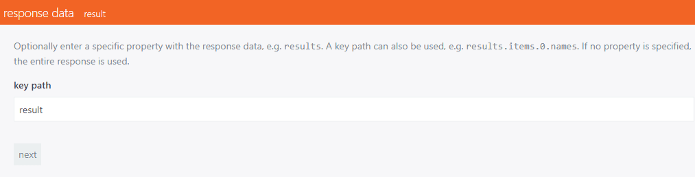

The reason we have this unexpected result is that there’s some nesting going on in the JSON response from ServiceNow. We need to tell SquaredUp where the data we want is within the response. The fact that we have a column name called result in our tile is a clue, but we can confirm our suspicions by intercepting the server’s response with our HTTP capture utility.
As in our example, the JSON object has a single key called result that contains other JSON objects, each made up of its own keys and values.
Let’s move on to the response data panel in the Web API Tile configuration and put result in here:
That’s more like it. At least the results are mostly readable, but annoyingly the assigned_to column has got [object Object] for some of the entries.

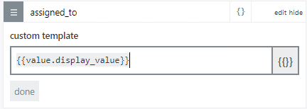

Looking at our HTTP capture response again, we can see why: assigned_to contains another JSON object as its value, so we need to specify the display_value key within this object to get the user’s name. We can do this within the grid columns panel in our tile configuration.
We’re going to use a custom template on the assigned_to column to do this. Clicking edit then clicking the curly braces button displays the properties of the assigned_to JSON object. This shows the display_value and link properties in this object, so it turns out we don’t need an HTTP capture tool to find the information we need; SquaredUp will display the keys and values in nested JSON objects to help us select the right one.
Clicking value.display_value in the drop down list then automatically populates the custom template field for the column:
This tells SquaredUp that, for the assigned_to column, it should display the text associated with display_value rather than the entire assigned_to value (which is a JSON object, hence [object Object]).
The result for the Assigned To column now looks how we would expect it to look:
Now, to be honest, we could have avoided having to do this column configuration by specifying the sysparm_exclude_reference_link parameter and setting its value to true in our headers and data tile panel. With this in place, the assigned_to result would simply be the name of the user, rather than a JSON object containing other properties and values. However, you might need to connect to an API that doesn’t provide this as an option, so it’s useful to know how to edit columns to return the value that is of interest to you when a JSON object is returned.
